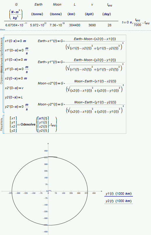

VValeryOchkov24-Ruby IVFeb 26, 2015 11:45 AM UTCQuestionCase 6: Earth and Moon1 reply1884 viewsTranslate AllIn Mathcad Prime 3 - without animation but with units 1_Earth-Moon-mcdx.zipOther
