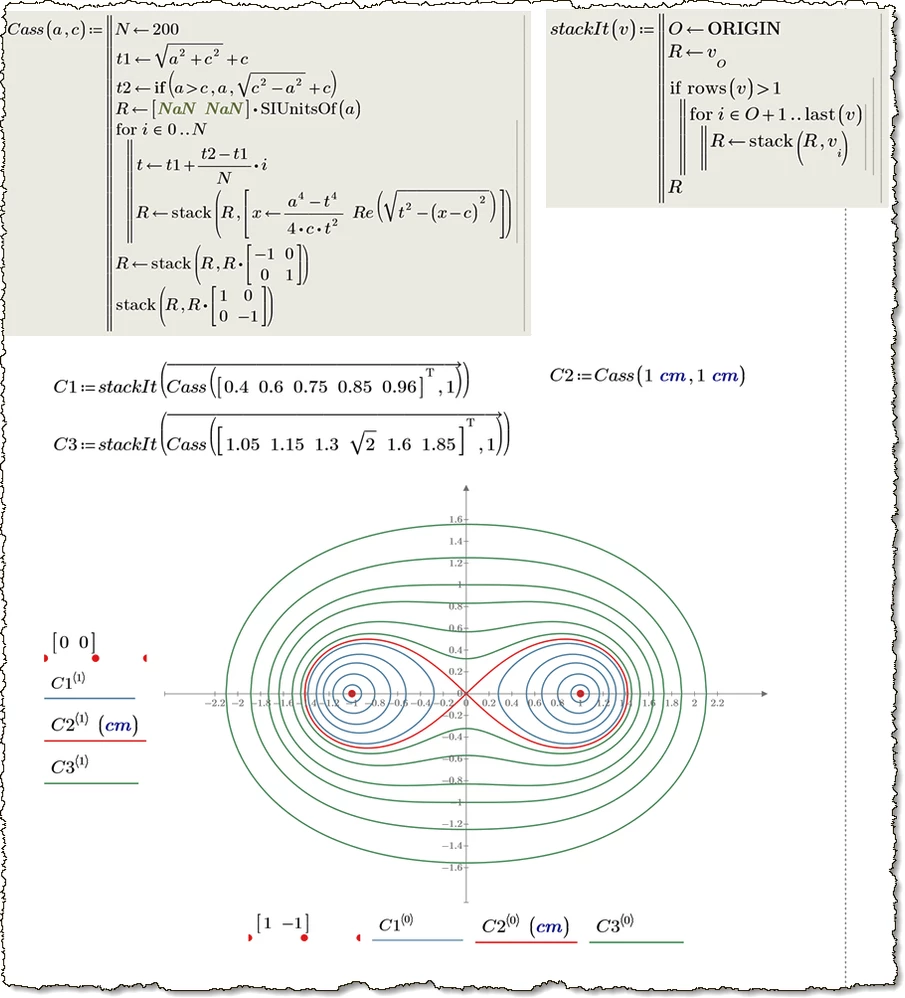

One possible way

Thanks, but it's better this way. And the function implicitplot2D will not help here. This is the Leo Tolstoy oval - a special case of the Cassini oval. See Ovale de Cassini (mathcurve.com)

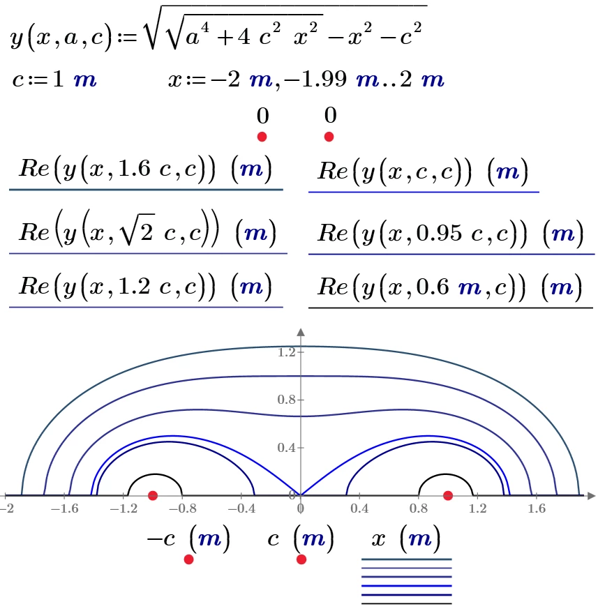

And in Prime, the Ovals turn out to be somehow lopsided. Why?
