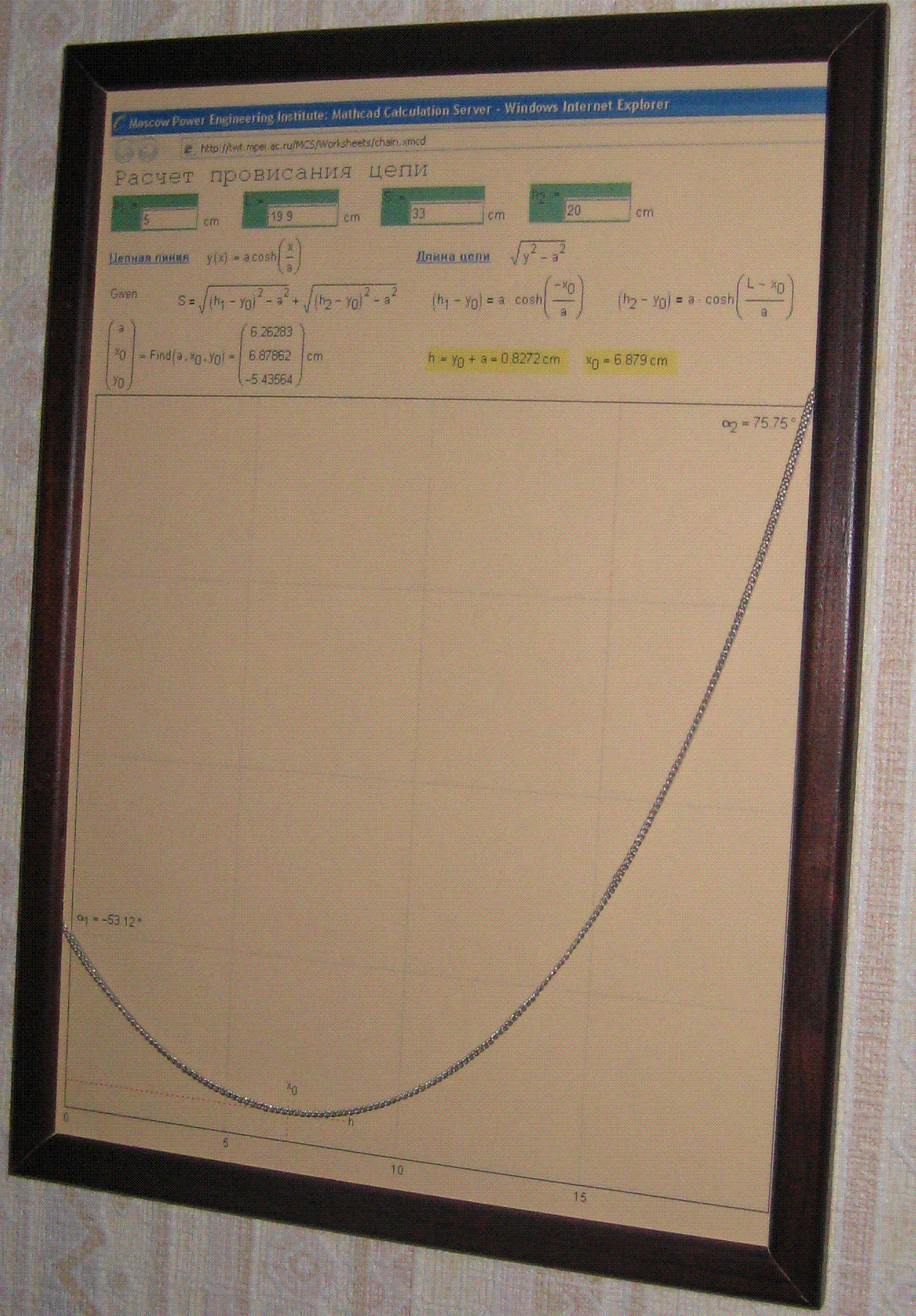

Now I am preparing one gift for my mathematical friend - one wall-picture with two Catenary - a real and a virtual covered the real.
The virtual Catenary is here ( http://twt.mpei.ac.ru/MCS/Worksheets/chain-frame.xmcd )
The gift by the testing is
Val
http://twt.mpei.ac.ru/ochkov/v_ochkov.htm
