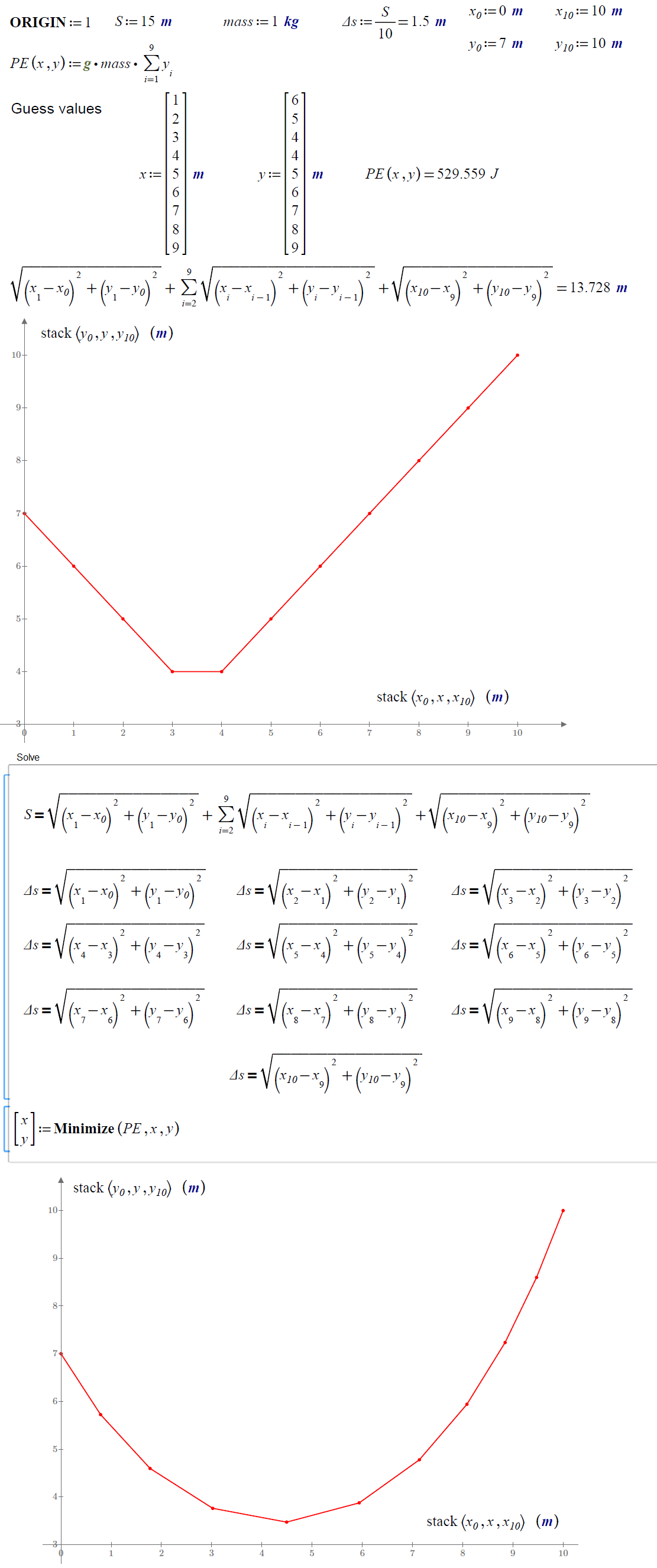

Catenary - one other method solution - what is not correct
I try to solve the Catenary problem with the method of Potential Energy - what is not correct in Minimize and Miner functions or in the model?
Two Mathcad 15 files in attach
Thanks!
May 28, 2016
I have done it! Only in Prime with new solver! And the PE (potential energy) must have not 1 but 2 argument!

May 26, 2016
And we need use not a lot of variables with index y.0, y.1 etc, but vectors x, y etc!

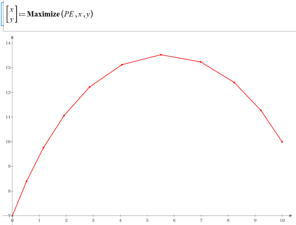

May 28, 2016
PE-Arch.pngAn Arch with the Maximize-function:
