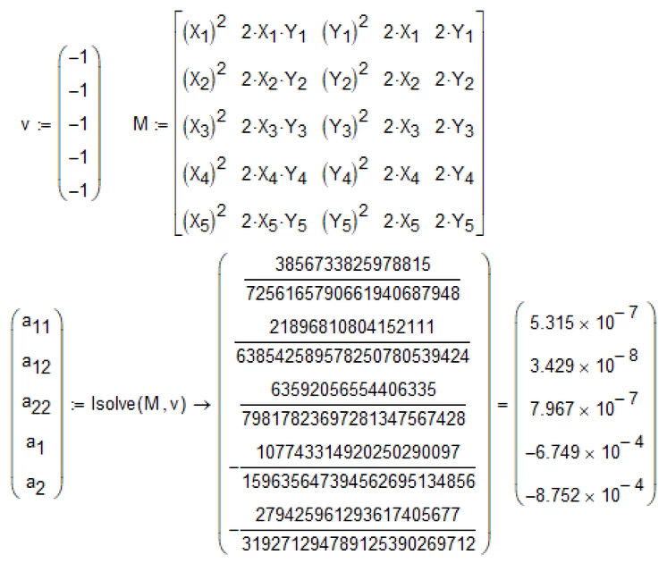

December 28, 2017
With lsolve function! We do not need guess values! But how can we add more points (6, 7, 9 etc) without change the Matrix M and the vector v?
