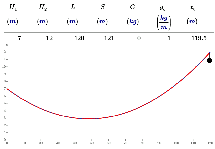

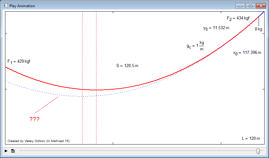

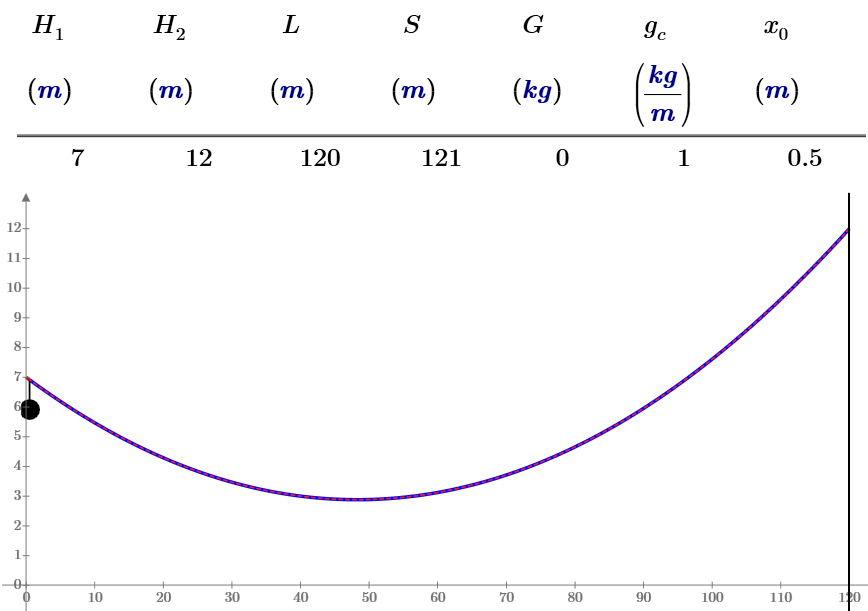

I hope I have solved this old interesting problem - One catenary problem
See please pictures and attach (15 and Prime).

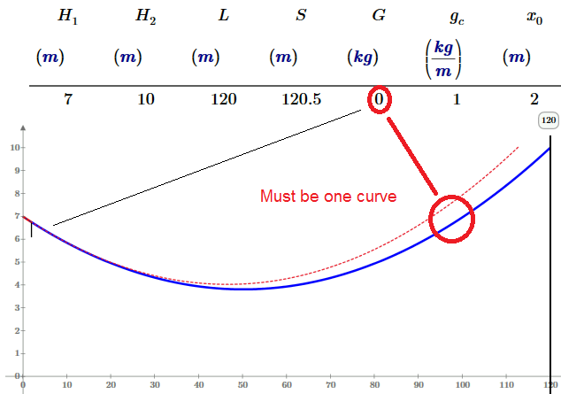

But at G=0 and x.0=1 m I have not one chain - is it an error of Math model or of a numerical method of 9 equations solution?
At x.0=40 m and others not at two fix points all is OK
Werner! Where are you?
RichardJAnswer
May 31, 2015

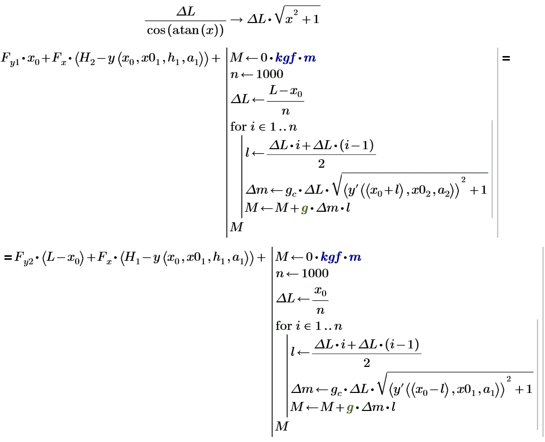

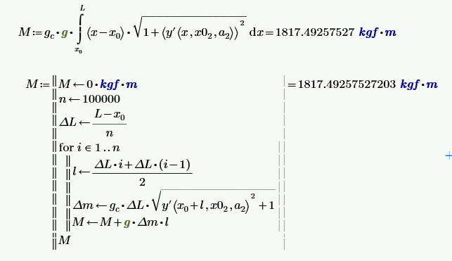

Well, I was going to say that your expression for Delta_m was wrong, because it should be gc*Delta_S, not gc*Delta_L, but I see you already fixed that
So your fixed program points to the correct form for the integral:
17 replies
May 26, 2015

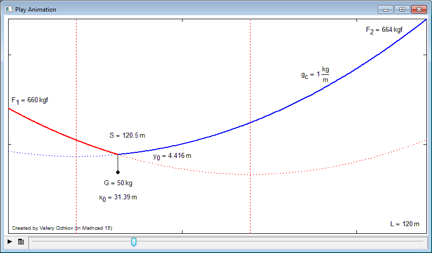

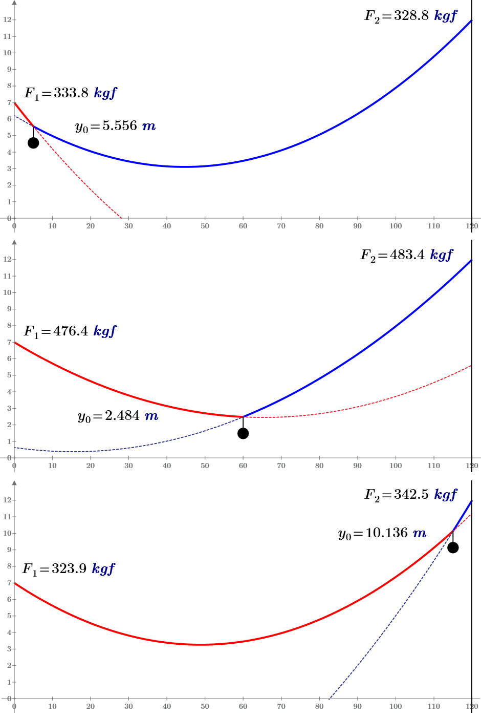

I can not insert a video. See please two frame of two cases
and with error
and video (may by it is OK)
Video Link : 6089
May 28, 2015
May by the error is here
May 30, 2015
I'm not a big fan of typing
Could you post a worksheet with the evaluated integral and the program.
May 28, 2015
I think it's just a numerical issue. With x.0=40m you can still see a difference between the two curves at 120m, it's just not as obvious. When x.0=1m you are extrapolating the curve by more than a factor of 100, so even the smallest error in the calculated curve becomes very obvious.
Edit: now I'm not so sure. If I change the algorithm for Find, or if I change TOL and CTOL, it makes no noticeable difference. If it were a numerical limitation I would expect something to change.

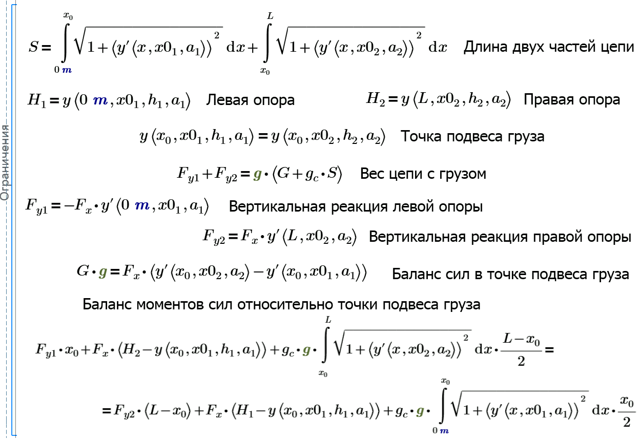

May 29, 2015
Thanks, Richard.
I think, the error is in the torque formula.

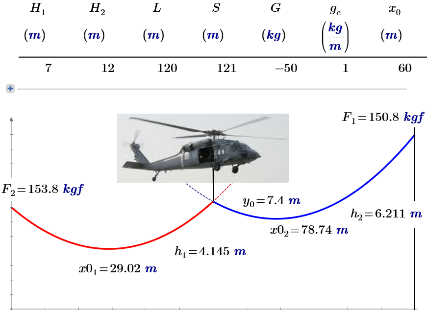

May 30, 2015
I hope I have correct solution.
Now we can solve new task with 2, 4, 4 loads
The 9-th equation must be
and no problems
RichardJ19-TanzaniteAnswer
May 31, 2015
May 31, 2015
Thanks Richard. Would you like to be one coauthor of this chapter/article? Welcome!
I have added your integral in the book with one remark:
На рисунке 7.15 показано уточненное уравнение баланса моментов сил, в которое было вставлено определение момента сил от веса провисающих цепей, заданное с помощью цикла с параметром. Цепь разбивается на 1000 элементарных кусочков (элементов) со своим моментом сил, которые суммируются.
Но сумма (рис. 7.15) предпочтительней интеграла в русле основной идеи первого этюда книги, утверждающей, что в формуле должна быть видима ее физико-математическая суть. В сумме она сразу видна (суммирование моментов сил от элементарных участков цепи), а в интеграле – нет.
And more
Наши расчеты показывают, что мост или канатную дорогу нужно испытывать не только при максимальной, но и при минимальной (нулевой) нагрузке. И даже при отрицательной – см. рис. 7.19.
Мы уже упоминали в сноске, что инженер должен решать не просто технические, а технико-экономические задачи. Если, например, под нашей ЛЭП должен проплыть всего лишь раз аномально высокий объект, то можно не строить высокие мачты или не натягивать излишне провода, а… приподнять их с помощью, например, вертолета. Кстати можно заметить, что у летящего с внешней подвеской вертолета трос тоже прогибается не по прямой, а по цепной линии. И это тоже можно обсчитать, используя подходы, описанные в этом этюде.
