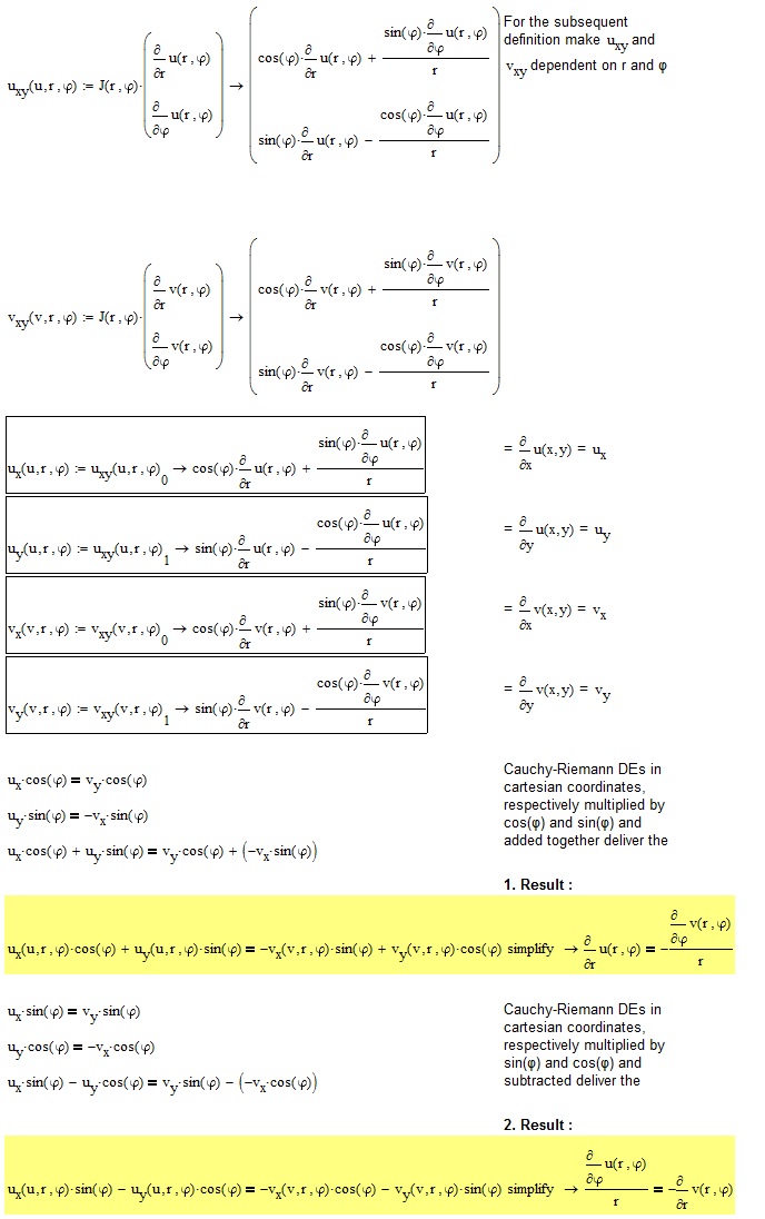

Hi all,
I've deduced the Cauchy-Riemann DEs from x-y coordinates to polar coordinates
using Mathcad's symbolic capabilities.
Greatings.

How did you get the partial derivatives in the results ?
Did you change the default settings ?

You can get it so:
from the toolbar click on tools, then choose from the menu the penultimate item ie worksheet options.
