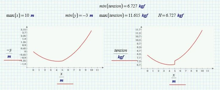

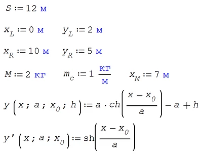

This is my first ever Mathcad 6 worksheet.
I have added units converted to Prime 8.
The worksheet manually iterates to a solution.
Want to one day automate the iteration
Worksheet gets H=6.64 kgf compared to your 6.833 kgf
terryhendicott

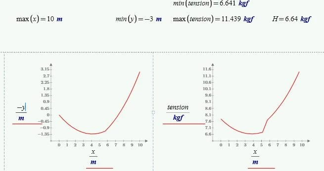

Hi Valery,
I have automated the iteration so it is possible to close to smaller imbalances.
Have included it for you or anyone watching.
Cheers
Terry

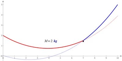

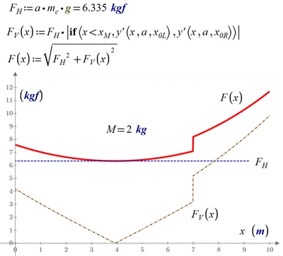

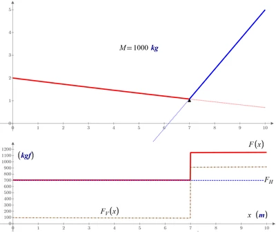

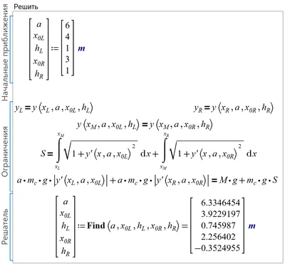

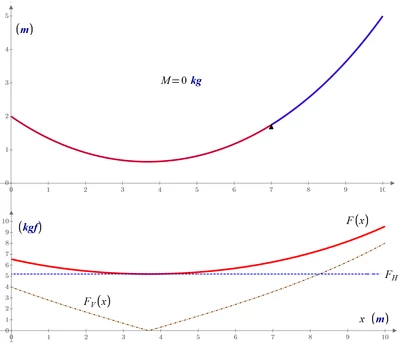

The task can be solved much easier - through Find, and not through Minimize. Or I'm wrong? See attachment.
