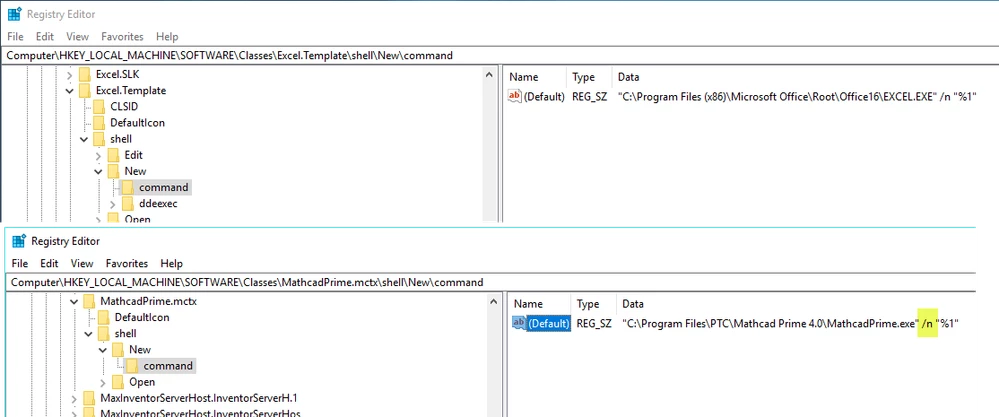

Considering that it's a feature/functionality of (windows) file explorer to determine what must be done when a certain file is double-clicked, it should be possible to do what you (verbatim) ask in the title of this topic.
When reading the contents, wat you want is that upon double-clicking a template file a new sheet file is created based upon that template, is something that may require support from the (Mathcad) application. E.g. by providing a command line switch that allows to designate the template file for creating a new sheet file.
I haven't seen that (yet).
Inspect your (Windows) register to see how the unctionality you want is implemented for MsOffice applications, and implement the same/similar for a mathcad template sheet and see if it works.

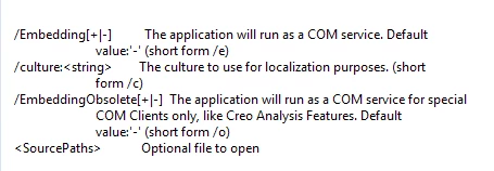

Thanks for the response. I tried exactly that. Unfortunately, the MathcadPrime.exe doesn't support the switch /n as Excel.exe does. Unfortunate.
November 29, 2018
Looks like Prime does not offer this feature and only supports the switches /c. /e and /o
