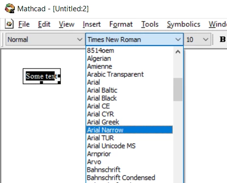

This is Mathcad 11:
March 8, 2019

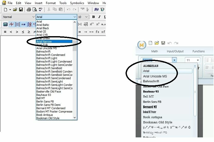

the searched font is only present in M15, it is missing in "prime"

Why it is missing in Prime!
If you list the windows fonts installed you find that some ttf fonts have subfonts embedded in them.
Arial Narrow, bold, italic and both bold italic are embedded in the Arial font ttf file.
Banhschrift does the same.
Berlin sans FB does the same.
If you look at MF's two pictures side by side you will see Mathcad 15 picks out both the parent and the child fonts whilst Prime only picks out the parent font.
Downloading just the arial narrow font ttf file and installing it does not undo this parent child font situation.
Prime needs to be reprogrammed to fill the list box with both parent and child fonts.  It is possible as all the office apps, Autocad, Photoshop CS6, Mathcad 15 all read the parent-child fonts?  Needs to be a feature request.
Cheers Terry
LS3211-VisitorAuthor
March 11, 2019
Luc, I am using Prime 5. That's why I am not able to use Arial Narrow. This sucks.
