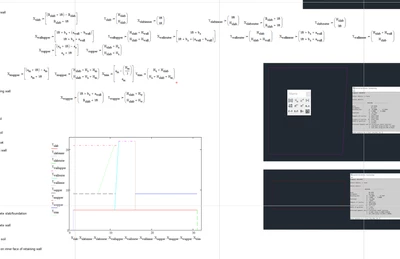

Changing graph that exists as a model.
I'm learning Mathcad and have been working on a problem using the software and had an idea of autogenerating a drawing using whatever variables I am given. To do so, I am using the XY plot graph function. I have created the plot and created some lines using my variable to get a general shape, but each line is infinite. I can't seem to figure out how to make each line a line segment that has an actual start and end. I have attached my Mathcad file which has all of the different variables and the plot, as well as some CAD drawings in there that show what my auto-generated drawing is attempting to look like. End goal is to have different loads being shown as arrows as well applying force to the wall structure.
The plot is at the very bottom after all my calculations because I have still been messing with it. I have tried to use boolean equation stuff and matrixes to no real success. I am using Mathcad 15.
The problem is a basic statics problem where I solve for loads on a retaining wall.
Thanks for the help,
Daniel

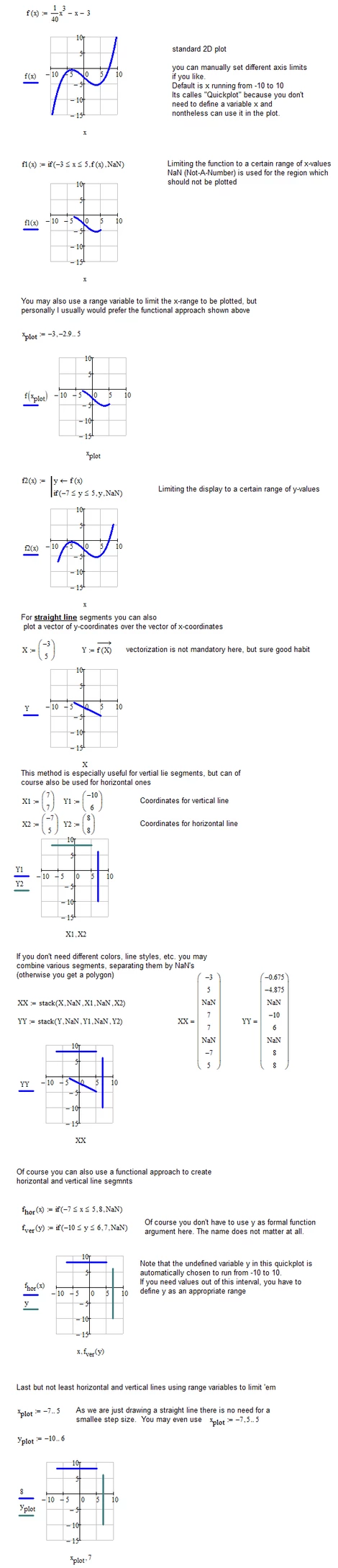

It wasn't really clear to me which plots you actually expected.
So I provide some general informations about plotting, limiting plots in x- or y direction and plotting line segments.
MC15 file attached

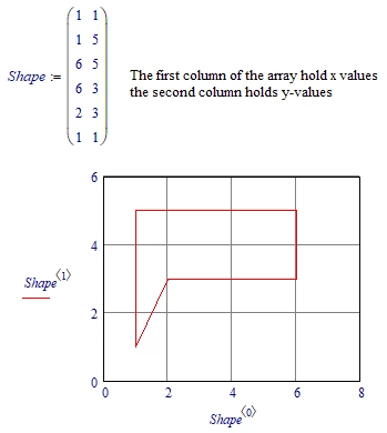

If you actually want to draw line drawings in the plot, you may be better off defining an array.
(Note that an array is something different from a range!)
Here's an example

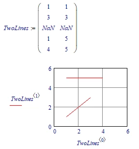

And you can draw multiple shapes using just a single array. Points that contain NaN values are not plotted, so, to draw two separate lines you can:
Jun 7, 2023 10:49 PM UTC
I saw this response second and was a bit confused but got me on my track to finishing up my graph, thanks for posting a second option so quickly.

Jun 7, 2023 9:05 PM UTC
MC15 file attached
Jun 7, 2023 10:54 PM UTC
This explanation and option was really helpful, thanks for the mathcad file that allowed me to quickly see the different examples and quickly mess with them and better understand the information presented. I used this the most fixing up my graph. It's still a bit in progress because I am trying to possibly add the loads as vectors but I am not entirely sure how to do that. I haven't explored it too much yet as I am also figuring out how to best represent different load triangles or if I will at all. I've attached a semi-messy updated document to this reply because I thought it was cool to see the graph function. Its midway down the document if you want to check it out in more depth. I'll also probably look into stacking up some of the lines to have them be the same and less messy.
Thanks once again,
Daniel
