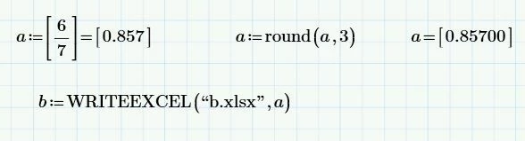

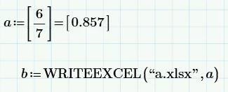

Yes it is possible to use the "round()" function on a matrix of numbers before the writing to excel.
With no round statement.
With the round function.
Cheers
Terry

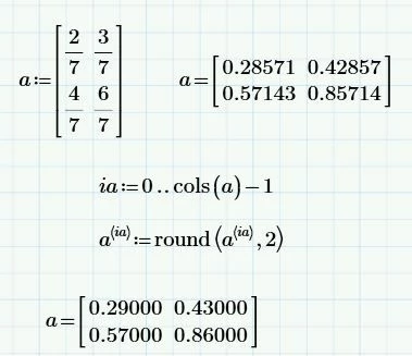

"So in order to round a large matrix, I have to use some for loops to go through that matrix. "
Yes the round function can be applied to a vector all at once so you loop through the columns of the matrix.

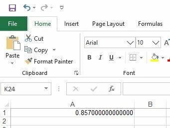

"Looking at your example I still see that 15 decimals are exported to excel... A solution for this is to set the cell format in excel to 2 decimals for example, but then I have to perform this action every time I have exported data from Mathcad.
Is is possible to only send two decimal values to excel?"
It does only send two decimals to excel.  I formatted excel to show 15 decimal places.
This is how excel shows without formatting straight after transfer.

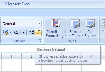

There should be no need to use the ROUND function within excel. You can just set the number of displayed decimals in the number formatting section of excel:
