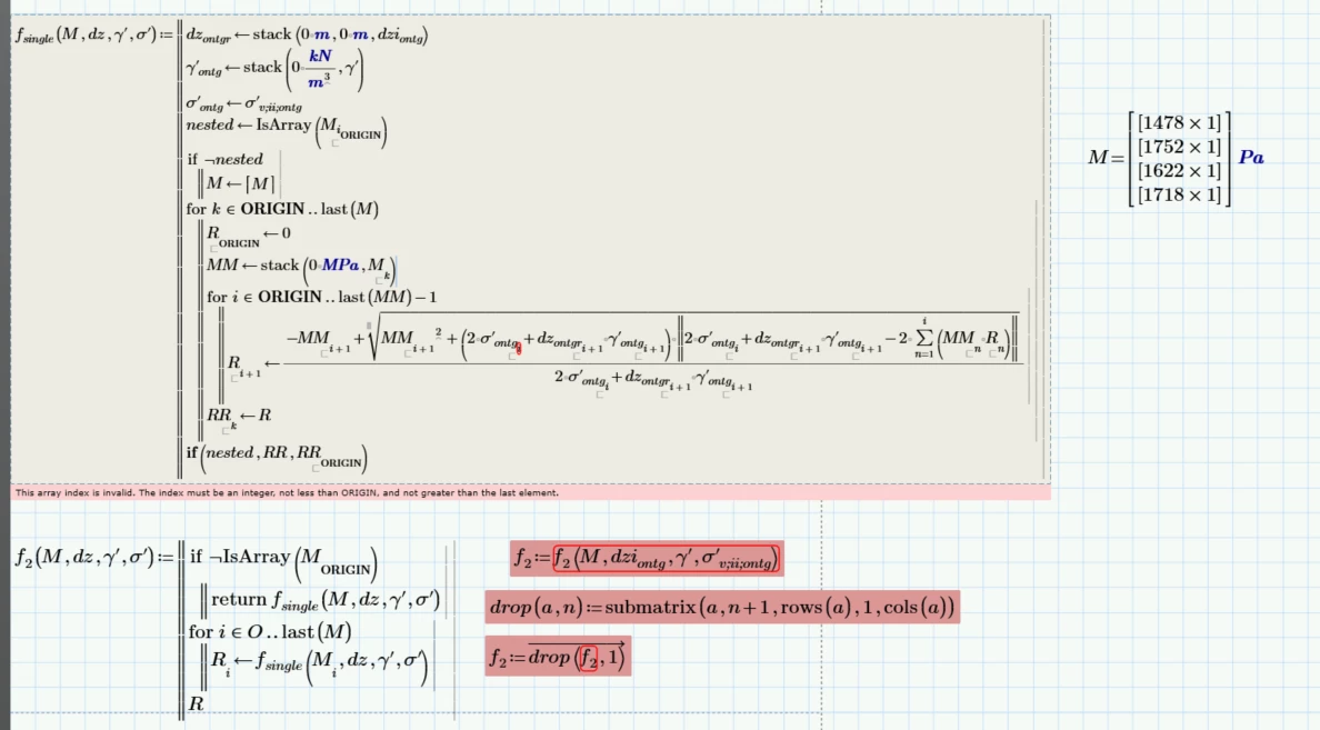

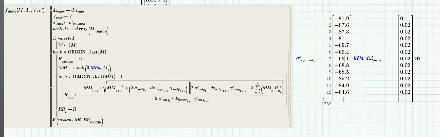

I have two functions are exactly the same but in two different sheet in the first sheet . it works perfectly and I’m getting the expected answers for f2
In the second sheet it doesn't work and I suspect the reason is M has different arrays . How can I fix this function : the error says : This array index is invalid. The index must be an integer, not less than ORIGIN, and not greater than the last element."
I can’t attached simplified sheet even in zip file. I hope you can help
Thanks in advance ,
Yusra

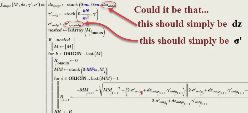

According to the error position the problem seems to be with your sigma’.ontg variable which seems to have not as many elements as the corresponding vector in M.
i also notice that your function has four arguments but it uses only the first of them (M).
The other arguments dz, gamma’ and sigma’ are not used at all in the first picture. In the second gamma’ is used, but dz and sigma’ still not.

It doesn’t make sense to define a function with arguments which are not used in the function in any way!
Check if the sigma’, gamma’ dz which you are using in the program have at least as many elements as the largest vector in M.
Otherwise thats the reason for the error und you have to decide what to do with a vector in M which has more elements than sigma’, etc.

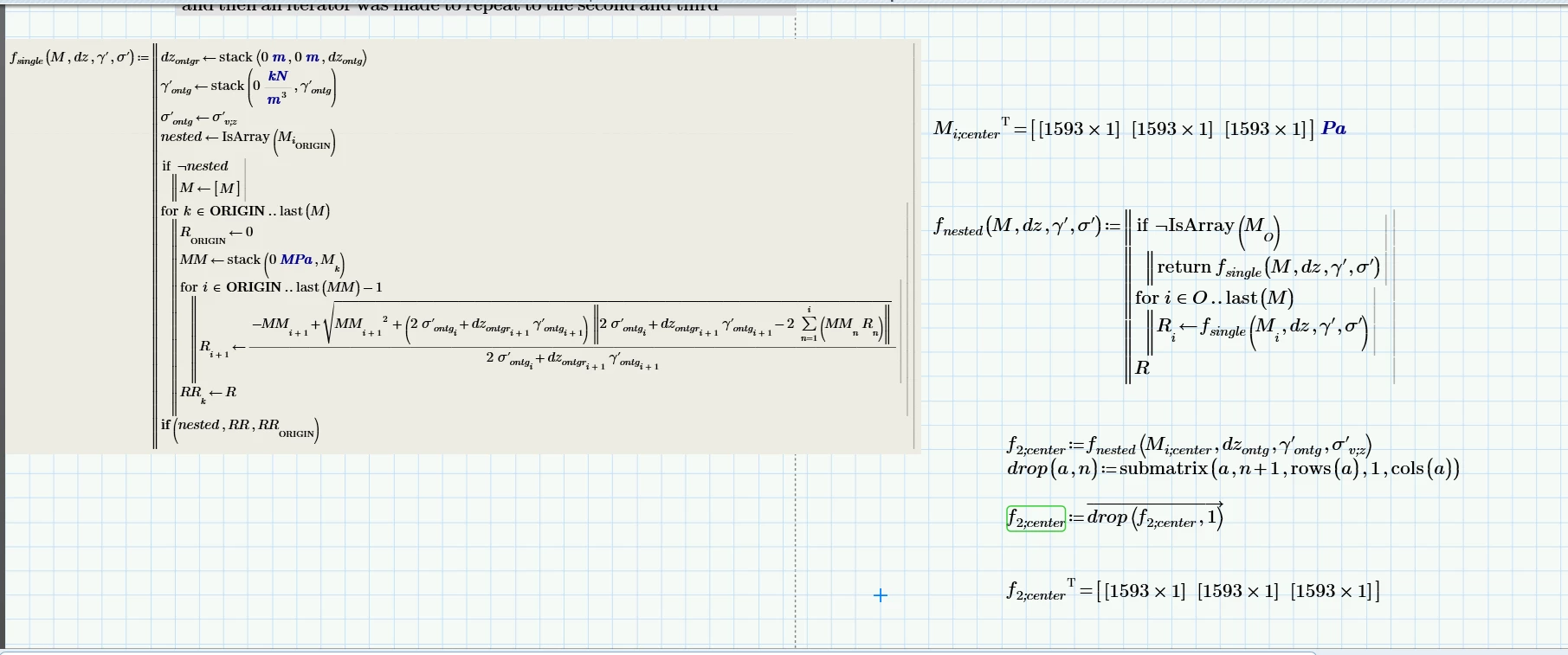

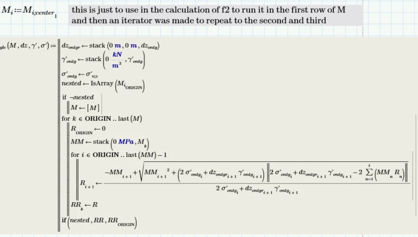

Yes you are right dz , sigma have [ 1752] rows , however M has [ 1478x1] [1752x1][1622x1][1718x1]  and I defined Mi to be [ 1478x1] like the first row

The sigma which has to have at least 1752 elements is sigma’.v;ii;ontg which is defined somewhere above the position picture is showing.
sigma’ which seems to be defined also somewhere in your sheet does not matter at all because, as already written, the function does not use the argument at all.

sigma’.v;ii;ontg .. this one has 1752 element and dzi_ontg has 1752 and the longest array in M is 1752 but still the function doesn’t work .. what should I do ?
R : has to calculate the sigma for the layer and the M and ( gama X dz) for the second layer

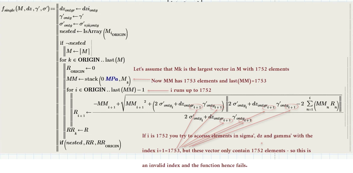

Have you made any changes to your sheet since the screenshot in the very first post here?
I'm confused and, in any case, I can't see why the error shown in the image in your first post should occur with sigma if both sigma and the largest vector in M have the same number of elements.
However, it is definitely a problem if `dz` and `gamma` don’t have at least one more element—see my comments here:
I can’t say for certain what you should change—that depends on exactly what you want to calculate when `MM`, `dz`, and `gamma` all have the same number of elements.
Obvious solutions would be to run the loop for i only up to last(MM)-2, or to add a sort of dummy element to the end or the beginning of the vectors dz and gamma.
However, I can’t say whether the results would still be exactly what you need.

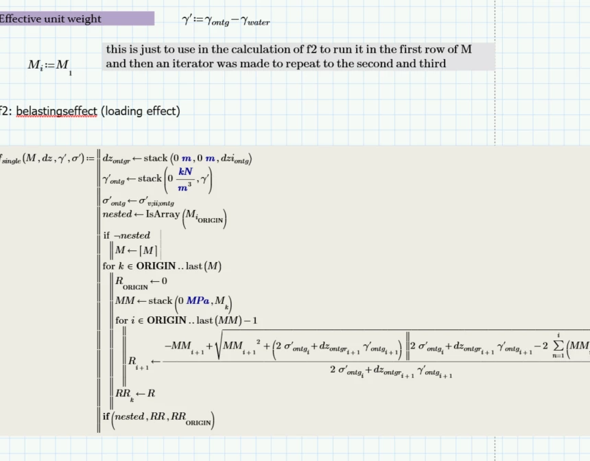

Yes it becomes slower .. in Prime 10 the same calcs were faster. I will update the file and share with you. Thanks for the help
