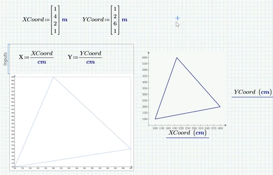

Something like this?
The far too tiny numbers in the chart component to the left are because the chart component does not scale properly if used with a higher screen resolution. Thats one of the reasons its useless for me.

Thanks Werner.  I already have a (large) defined vector to plot.  Just want the x-axis to be the element index of the vector and the y-axis to be the vector element values.  The chart component insists upon X being a scalar.

Like this:
