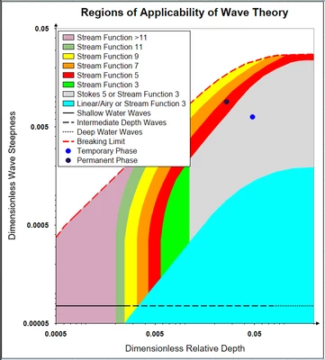

I recently calculated wave theory selection using Mathcad Prime 9.0.0.0. I'm curious, is there a way to determine the region automatically for given points? I want the function to return "Linear/Airy", "Stokes 5", "Stream Function 3", etc. based on the chart.
Does anyone know? I attached the full calculation below.
19 replies
No, Prime does not offer any automatic way to determine which area a given point would lie in.
You would have to program a function which determines which area a point with given coordinates is in and also would have to decide what to do with points lying on the border of two or more areas. Looks like quite some work to do.

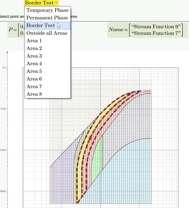

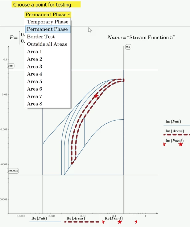

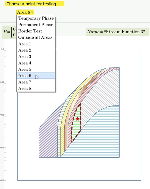

Here is my attempt defining the necessary polygons and determining the area a points lies in:
After saving the file and reopening it the region with the Chart component was corrupt and so I deleted it.
Prime 9 file attached
Added the hatching function by Prof. Birkeland.
Unfortunately the creation of all the hatch lines is very time consuming and the result is not as nice as we would like. Guess its also because of the log scale.
Hatching took far too long in my opinion. So I implemented a simpler approach, filling the areas just with dots.
Also added grid lines.
