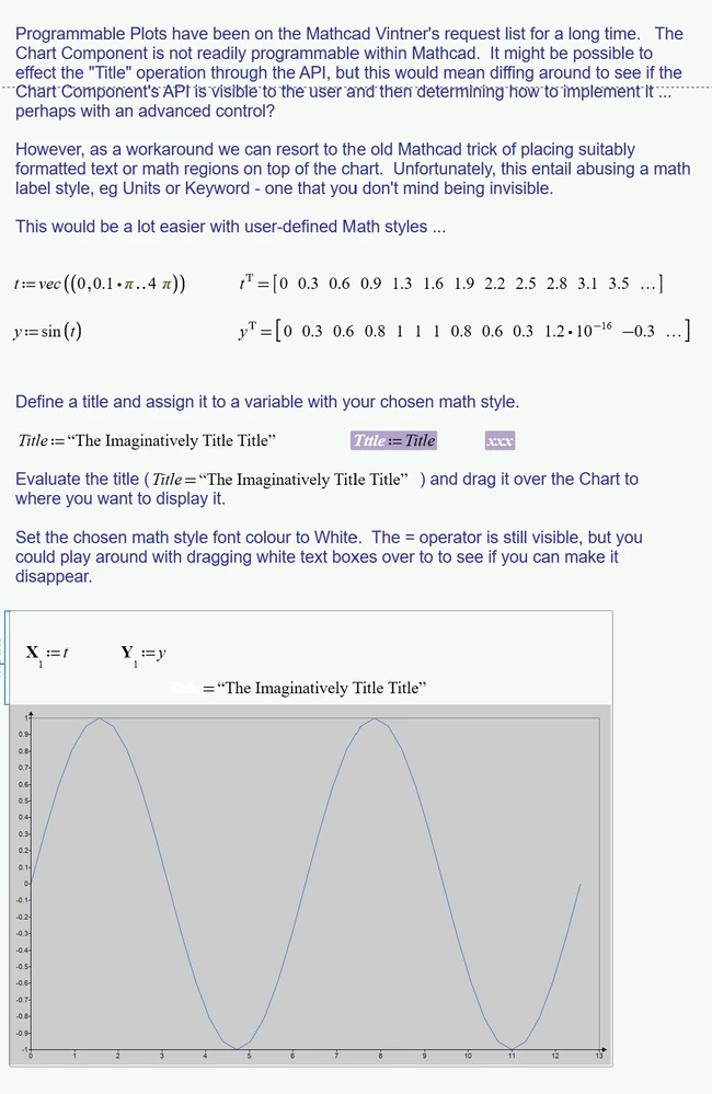

Not as far as I know and I'd be delighted to be corrected.  However, ...
Note that the Title is just an overlay and isn't attached to the Chart, so you need to select the Title as well as the chart if you want to move, copy or cut the chart.
Stuart
Oct 23, 2024 1:42 PM UTC
Instead of using the evaluation of a simple string variable (still showing the equal sign) you may use a Text Box with the string variable as its input. We can at least format fore- and background color and text size as well as setting the box read only. I don't think that we can get rid of the border line around the box.
The method of creating labels by overlaying text boxes or math regions sure is suboptimal. Of course we would wish for a better integration of the chart component in Prime - not only by providing labels defined by Prime variables but also by being able to deal with units - IMHO thats mandatory for an add-in to this software. Personally I would prefer getting rid of the slow and clumsy chart component altogether and improve the native plots with grids, labels and all the features provided by the component.
