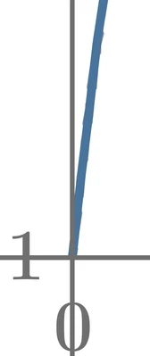

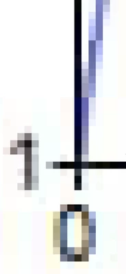

Apr 4, 2025 2:08 PM UTC
Confirmed!
Here Prime's native plot
and here the Chart component
Prime's native plot is a shame in many ways, especially given that one of PTC's main programs is a full fledged CAD application. But obviously it has the advantage that its not limited to a fixed pixel resolution.
I guess there is nothing that could be done on your part to significantly improve the quality of the printouts other than hoping for an improvement in a future version of Prime.
