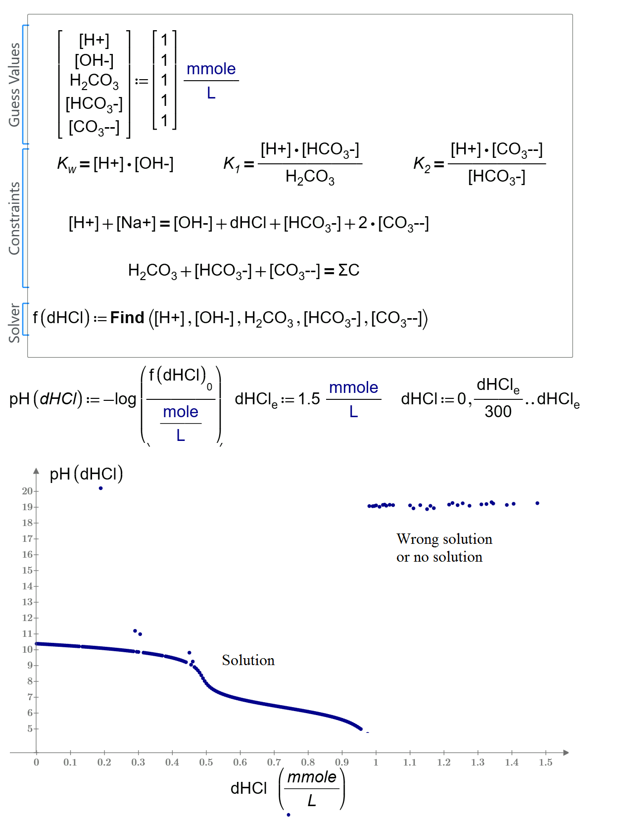

Chemical variable
Do you know that we can use in Mathcad Prime? See the picture and try the Prime 3.1 attach!
I have created this variable in Mathcad 11 thru Shift-Ctrl-j, opened in Mathcad 15 and convert into Prime.
You can copy variable from my sheet, edit its and use in your Mathcad Prime chemical calculation!
thanks, Werner

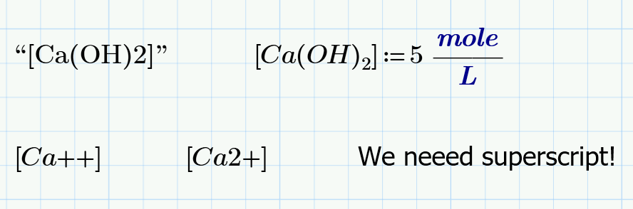

Yes, sure. But this is not our biggest and primary problem with Prime. We need much more than that! And chances are we won't get it.
