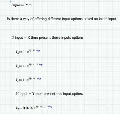

I think my question was not clear.
Essentially I want to be able to present  different "blocks" of input pages depending on the selection.
So if I select X then present one set of inputs.
If Y selected then another set of input options is presented.
Like a dynamic show/hide ??
