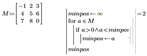

choose minimum positive number
hi
for example if A=(a,b,c,d,e) and a=1, b=-3, c=4, d=2, e=-1,
how can I choose "d"(minimum positive number biger than one)
"A" is matrix

PS Without zeros!
Or a little program

December 17, 2015
Maybe that way:
But using the built.in functions match and trim you get into troubles if all values in A a bigger than 1.
Solution can be to write a program for your task or rewrite match and trim to work even if nothing has to be trimmed.
