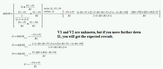

Hello everyone
I attached tow work sheets with PRIME7.
I was very surprised about I1 ...
Is this a bug? Or is this joke?

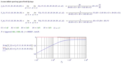

Mar 22, 2021 1:16 PM UTC
The circuit is an Antoniou inductance simulator. In fact, the result gives an impedance proportional to CR² which dimensionally is an inductance (FΩ² = H).

Mar 22, 2021 6:23 AM UTC
I want to know the electric circuit that you want to solve. Including the points with voltages and current flows of the elements.

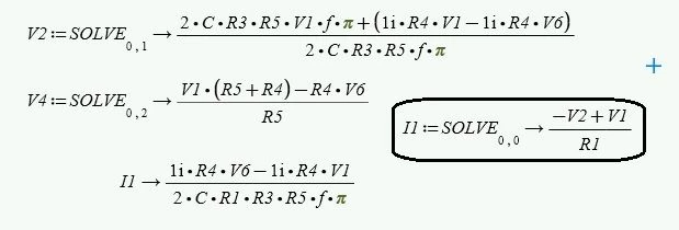

ssato15-MoonstoneAuthor
Mar 22, 2021 7:19 AM UTC
Hello ttokoro san
I attached circuit diagram and some equations.
I have been able to obtain I1, V2 and V4 from the file "sample1" I attached earlier.
I have two questions.
  1. V2 remains in the solution of I1 called from SLOVE.
  2. The only difference is where SOLVE calls I1.
The solution is different when symbolic I1 is called again.
The solution of V2 is substituted into one of them to obtain the solution of the equation.
On the other hand, V2 remains.

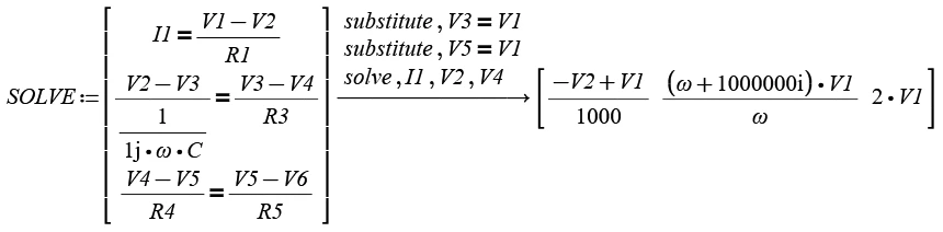

-MFra-
Mar 22, 2021 9:38 AM UTC
Mar 22, 2021 10:50 PM UTC
Hello MFra san
Thank you for your advice.
I assume V1 is the source voltage and a known constant.
So I think I1, V2 and V4 are unknown and can be solved by three equations.
In fact, Ver. 15 gives 3 unknowns without problems.
It looks like a PRIME 7 problem.

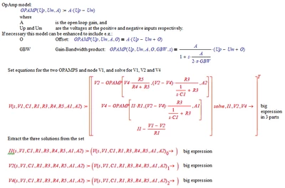

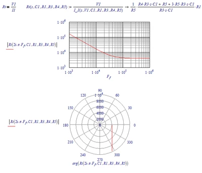

23-Emerald V
Mar 22, 2021 1:04 PM UTC
How about:
The circuit presents itself as an impedance to the voltage source. That impedance is:
-MFra-
-MFra-21-Topaz IIAnswer
Mar 22, 2021 11:54 PM UTC
Hello everyone
This circuit operates as an inductance"L" when an ideal operational amplifier is used.
L=C1*R1*R3*R5/R4
