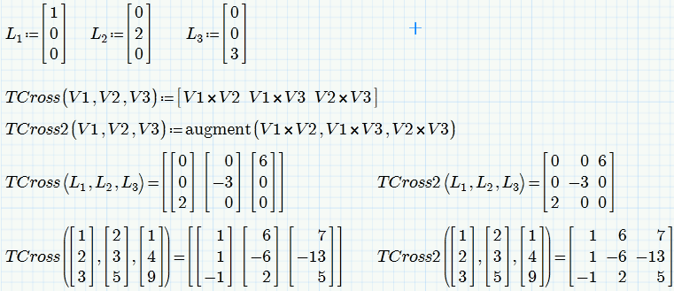

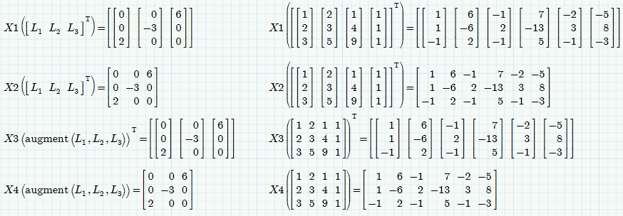

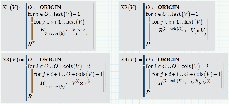

Sure you can do it using Prime's programming facility, but in my opinion this would not be worth the effort. The direct way would be the easiest and most elegant one and it depends upon your needs in which way the result should be presented. Either a nested vector or a matrix:
If you intend to make the number of vectors variable and apply the routine to a larger number of vectors and not just three, a programming approch is needed. Again depends on your preference and need which dataformat for input and for output you'd like to chose. Here are some ways to do it.
