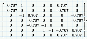

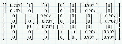

like this.
April 17, 2016
We can create a program for the converting a nested array into a matrix but better to see how do you get this nested array.

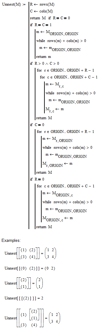

Something like this:

However, I agree with Valery that it would probably be better not to create the nested matrix in the first place.
