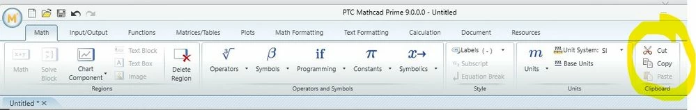

Yes. select the region or even multiple regions.
You can even select parts of equations
Use the shortcuts ctrl-C or ctrl-V.
You can also use the ribbon Math | Clipboard | Copy or Paste
