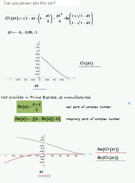

G1(x1) is like this:
Can you please plot this too?
Thanks a lot.
Anousheh

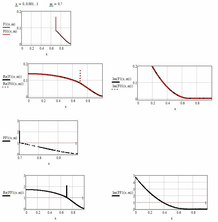

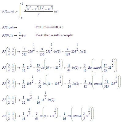

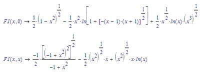

I calculated the integral, but we must study the function, for x = 1 the integral is complex. See next photo:
April 27, 2020

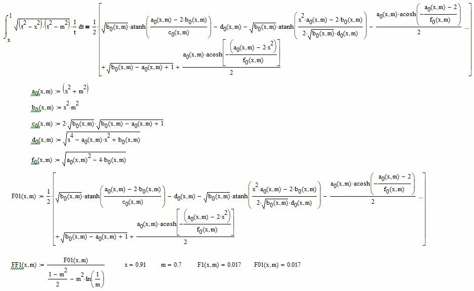

my solution, see photos:

April 28, 2020
