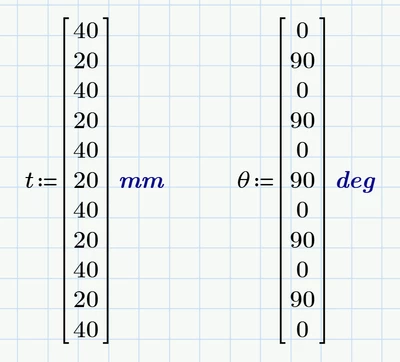

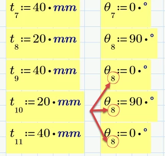

1) It might be easier to input the values for the thickness vector "t" and the vector theta (which is not used so far in your sheet) not singly but as  vectors (start with Ctrl+M an then; Shift+Enter inserts a new row).
This also avoids errors like this in your sheet 😉

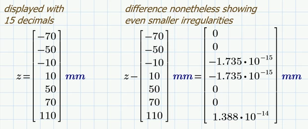

2) To check for exact values it often does not suffice to display the values with the maximum of 15 decimals. You may display the difference of the calculated vector and the vector of exact values (you can use copy and paste) to see even smaller round off errors:

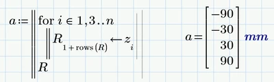

Subtraction of t/2 and rounding could be done in one go:

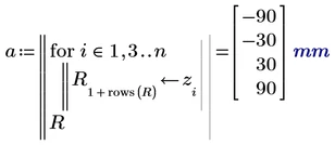

4) Calculation of values and displaying the results in one single region often works OK.
However, Prime can sometimes produce strange effects and even errors—especially in combination with matrices.
For this reason, I have gotten into the habit of separating the calculation and display of values - just to be on the safe side.
