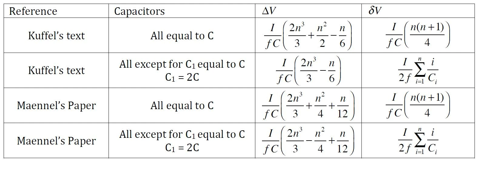

What I am trying to do is evaluate two sets of equations describing the output voltage sag and the output voltage ripple found in the Cockcroft-Walton Voltage Multiplier.
See the table in the figure attached to get an Idea of what equations I am trying to compute.
I am trying to do so for a limited number of combinations between specific parameter values. For example, I want to test every possible combination for 3 values of frequency, 3 capcitance values and 3 stage values. Thus, 3*3*3=27 results for each respective equation.
The problems I am running into at the moment is that MATHCAD is complaining that n must be a scalar value in some of my equations, and how I am going to work with the summations found in the equations.
Also, am I defining the particular values I want to test correctly? (i.e. f = 100, 500, 1000)
How is this going to work for C, since it is also being used in the summation.
Also attached below is my current mathcad file.
Hopefully you guys understand what I am trying to achieve and can help me correct my mistakes.
