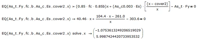

You mean like this:
What version of Mathcad or Prime are you using?
pyoyoon1-VisitorAuthor
March 9, 2020
Thank you!  It was perfectly working for my purpose!
Actually, my equation is a bit more complex.
Your suggestion perfectly worked!
When I tried to solve the original without using EQ(), my MathCad 14 just returned the red-colored original.

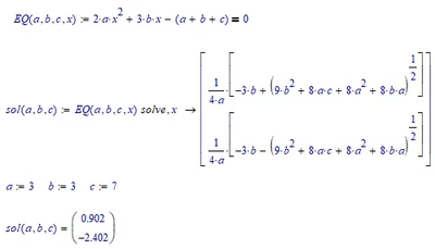

You can also do it the other way around: First solve symbolically, then plug in the numbers. Like this:
