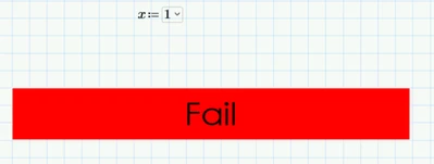

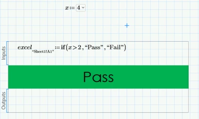

As of Mathcad Prime 9, there's no direct way to do this, but one workaround involves putting the results in an Excel Component as an Input Expression, and use Conditional Formatting there.

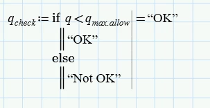

For example: My sheet has "q(allowable)" , and I find "q", how do I make the sheet to give me green if OK and red if Not OK. Please do a step or uplaod a mathcad sheet where you did it. Thank you

Attached a worksheet!
See if that helps and if you can figure out the rest on your own! I don't know the math behind q and the maximum allowable q so I just defined those as variables (and a combo box for fun), but you can replace those with whatever and it should work.
You can press the - by the Excel Component's input expression to hide it. The magic is that Excel Component input expression being equal, in this case, to qcheck, and if you double-click the Excel Component to open Excel, setting Excel's Conditional Formatting rules to activate upon "OK" or "Not OK" values.
