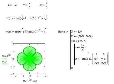

terryhendicott
Thought I'd get in on the act
Cheers

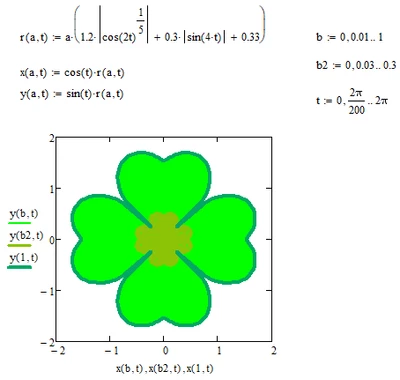

Here is a first try, hope it helps:
EDIT: Added a second (not necessarily better) way to color the interior.

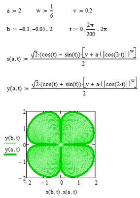

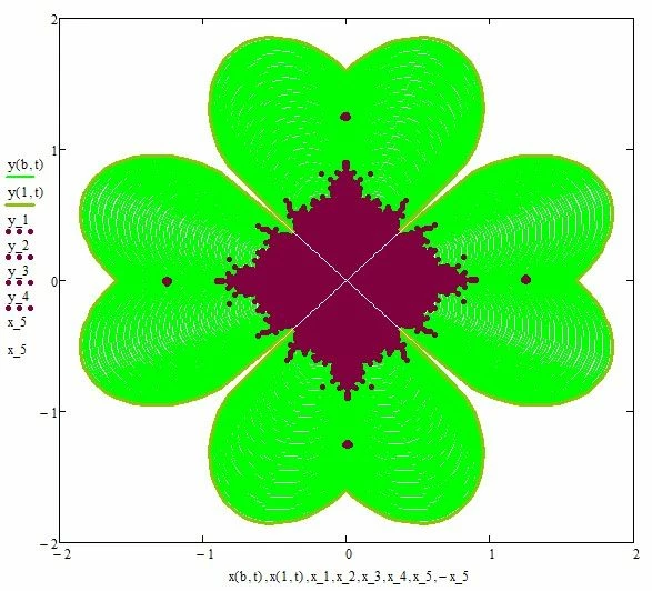

Nice! Here are some others ...
Still not the real thing, though, but I would say that Luc's is closest.

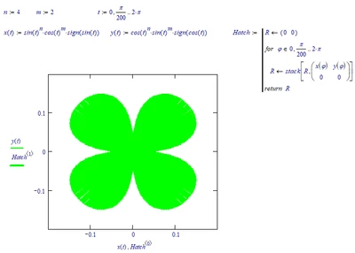

OK, last try for now ...
