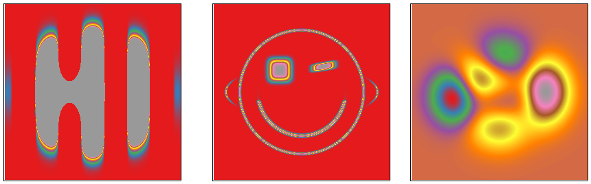

Does the attached help any?
You'll need to add the correct path for you Mathcad colormap folder.
Stuart

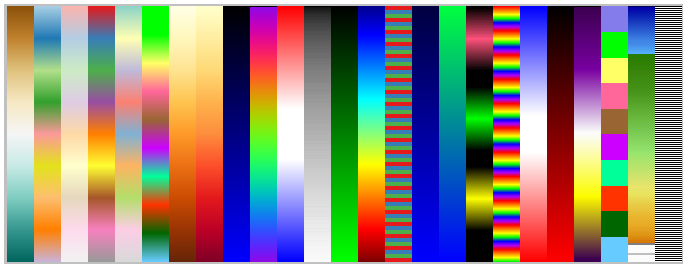

I don't think it does that ... the colour mapping interpolates, IIRC, so if there is no block banding of the colours (they smear together).  However, here's a simple function that should help.
Just create a string of the RGB values of your chosen colours (I used a standard colour picker and chose some at random), convert it to a matrix (using my conversion routine str2mat), pass to the block colour mapping function below and then save as a colormap.  (You could also just type the coefficients straight into a 10x3 matrix rather than do the conversion, but I find the string method easier)
The new colour map is the 3rd from the right in the map below.
