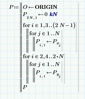

I request your help please with the following problem:
I need to run a for or similar loop that allows me to build a 1x (2N) array, where N is an input value.
That is, the array will always have an even number of rows. On each odd row the routine should place "Px" and on each even row the routine should place "Py".
Thanking you in advance for your help

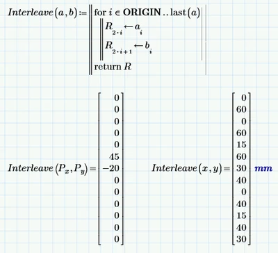

I made a mistake. You've set ORIGIN t0 1. My program needs a tweak.
6 replies
23-Emerald V
Jul 2, 2023 6:36 AM UTC
How about:
Jul 2, 2023 5:28 PM UTC

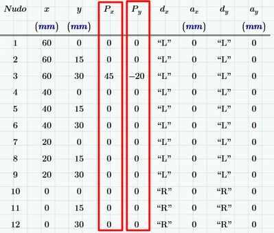

It seems that the results are not obtained in the positions that it should. For example, 45 would have to be in row 5 and -20 in row 6 and the array should have only 2*N=2*12=24 rows
LucMeekes23-Emerald VAnswer
23-Emerald V
Jul 2, 2023 5:33 PM UTC

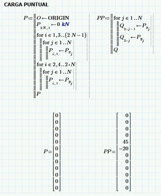

Jul 2, 2023 5:52 PM UTC
I have tried this, pero it doesnt work....
