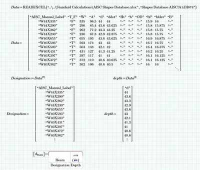

Hi All
Looking to create a calculation which uses a drop down box to select beam size. I would like mathcad to then automatically populate all the remaining characteristics of the beam into the appropriate variables. I have downloaded the AISC shapes database as an excel file so I am using the READEXCEL function to input the excel data to mathcad. A combo box seemed like a really good fit. I'm trying to input columns from my data matrix into the combo box but it doesn't seem to be working. Any ideas? A snapshot of the simple worksheet below.

Can it be because you wrote "Depth" instead of "depth"? Variable names are case sensitive.

I am just poking in the dark: You may check the labeling of the variables. When ever they occur this should be the same. If necessary you may manually label all occurrences of "depth" to "variable" or all to "-" (meaning autodetect):
I am not sure but it may be that Prime chokes on the first header entry of the columns "depth" which is a string"d" and not a number? In that case you may try depth:=submatrix(depth, ORIGIN+1, last(depth), ORIGIN, ORIGIN) to get rid of it in front of the combo box.
It would certainly make it easier for helpers with newer Prime versions to find the error if you could upload the worksheet  - or even better, a streamlined, simplified demo worksheet (without the need for extra Excel files to read in) which also show the same error.

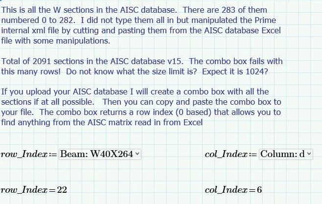

I adopt a different strategy than the combo box to get values from a large table.
Cheers
Terry

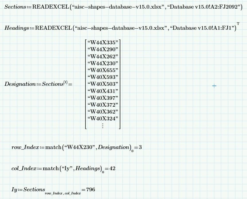

terryhendicott
Jun 18, 2022 3:28 AM UTC
Hi
Option 2
Cheers
Terry

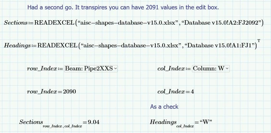

terryhendicott
Jun 18, 2022 5:28 AM UTC
Option 3
It transpires you can have 2091 rows in the edit box.  This database has imperial and metric quantities depending on what column you take.
Cheers
Terry

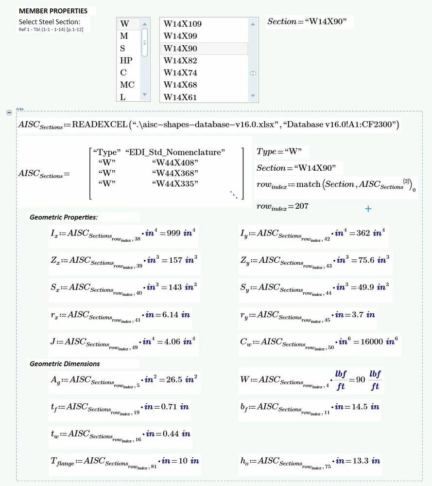

I realize this is an older post, but it helped me develop an AISC selection tool using the List Box from the Advanced Controls that are in Prime 10 so I thought I'd post it in case others were looking for this. I only pulled the member properties that I typically use however anyone can add additional definitions to pull other columns from the provided AISC database.
Notes:
  • I'm using READEXCEL so be sure to have a valid path for the AISC database.xlsx
  • The ORIGIN is set to "0" so if you're in a sheet that has been changed to "1" you'll need to update the column references accordingly.
