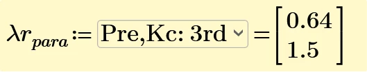

hello.
I am trying to make a combo box with multi choices of various equations depending on defined variables, the attached file will explain it very well.
how can I make it work?
thanks,

thank you, but unfortunately, I need to make equations inside the compo box.
Mar 9, 2023 2:25 PM UTC

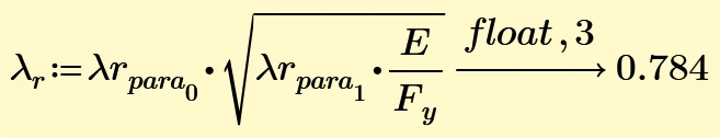

you can define combo box for two values:
numerical_coefficient ... 0.75, 0.56 and so on
Kc ... 1, 1, 1.5, 1, 1
... and use this "combo box variables" in equation.

Mar 10, 2023 1:53 AM UTC
 says that. Prime 7 sheet attached.
t.t.
