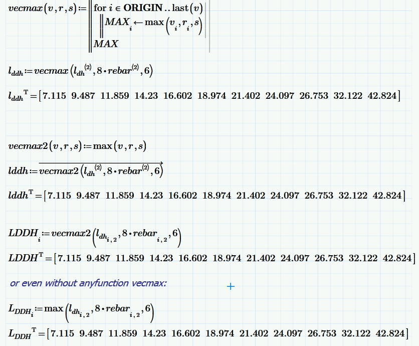

Werner_EAnswer
Here is the file with Richards suggestion of how to use your function along with an alternative approach using a function which returns simple the maximum of 3 scalars and then is called vectorized with the vectors as arguments. This function could also be used in the way you tried using the range i.
Regards
Werner

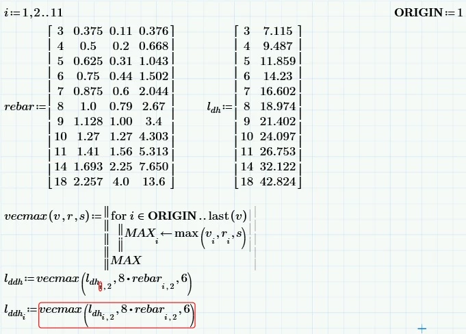

Your for loop starts at 0 and you have ORIGIN set to 1.

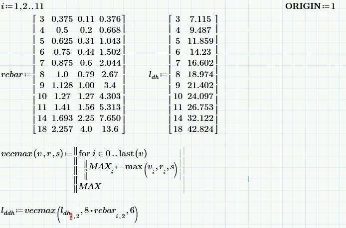

dsochor1-VisitorAuthor
Thank you Richard; that is a good catch. No dice though.
You should be passing vectors to the function. If you pass, for example, l.dh[i,2, you are passing a scalar value
