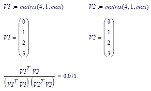

I have my doubts. I created two equal vectors and did the test:
Would this indicate they're not even nearly equal?
JXBWk14-AlexandriteAuthor
August 10, 2021
My apologies I mis-typed the equation. It should read [{v1}T*{v2}]^2 / [{v1}T{v1}*{v2}T{v2}]
I'll correct the orignal post

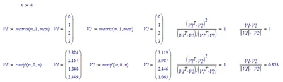

August 10, 2021
I still have my doubts, but I suggest an alternative, which is simpler:
Got the idea from: https://math.stackexchange.com/questions/1277288/what-is-the-best-way-to-see-if-vectors-are-equal
Where it says:
"You could compute the dot product of the two vectors, and if they are parallel (same direction) their dot product will be equal to the product of their individual norms."
