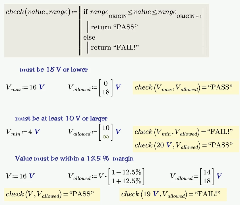

Im using Mathcad prime 9.0.0.0
need to create an analysis in which im comparing my results with my requirements.
need some kind of function to do that but not really sure where to start or what to look for.
something like
my maximum voltage calculated is 16V, but per requirement im allowed to go up to 18V
so want a function that compare this 2 values and show them like:
"Result: 16V  -  Margin: 12.5%  -  PASS"

Not sure if thats what you are looking for, but here is a function which checks if given value is within a given range of allowance and returns either the string "PASS" or "FAIL!".
On contrary to old Mathcad we cannot (yet?) format depending on the result or use scripted components. So the only way to return results which also are different in color, etc. is to use an Excel component. Would be to much overkill for me but it seems to be the only way so far if you want to see different colors (font size, style, etc.) depending on the result of the check.
Prime 9 sheet attached

Great!!
this is actually very helpful!
i guess i could even place the Check function for all my results at the end of the document and that would be easier to show like a summary matrix.
