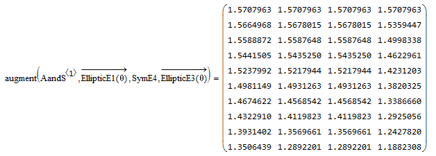

I'm having second thoughts about the hypergeometric function implementation.  (Well, when I say "thoughts", I mean the random firing of the miswired neurons that pass for my brain)

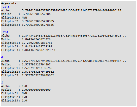

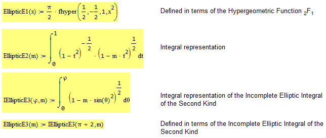

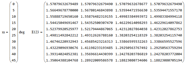

One of these random thoughts made me wonder how the values and execution times might differ between the different means of evaluating the elliptic integral.  So I created an integral representation, looked up some values in Abramowitz and Stegun (A&S), and ran a few values in Matlab and Wolfram Alpha.  I wish I hadn't because the hypergeometric form is different to the integral values, the A&S values and those of Matlab and Wolfram Alpha ... markedly so.
Unfortunately, the symbolic processor doesn't know about fhyper, so I couldn't it to check that the more limited precision of the numerical processor wasn't the source of the discrepancies.  I used hypergeom to get some symbollically-generated values to get round this problem, but (I can't decide whether it's for better or worse), I got the roughly the same values using hypergeom as I did using fhyper.
In addition, the fhyper-based function also had problems evaluating some values (see Matlab / Wolfram Alpha comparison below).
I don't know what's going on, and I haven't had time to look into it in any detail.
Definitions:
Comparisons with A&S:
Comparison with Matlab and Wolfram Alpha:

SymE4, in the results below, is the result of running EllipticE4 on the (0,5..45) degree range
Stuart
