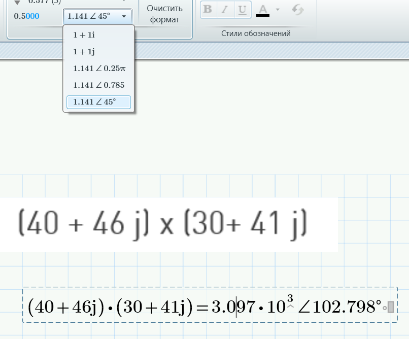

Hi
How do I do calculation with complex number in Mathcad Prime 3.1
Multiply the following complex numbers to determine the angle of the result, in degrees.
(40 + 46 j) x (30+ 41 j)
or
Calculate the following complex division to determine the imaginary component of the result.
(34 + 43 j) / (44 + 41 j)
December 8, 2015

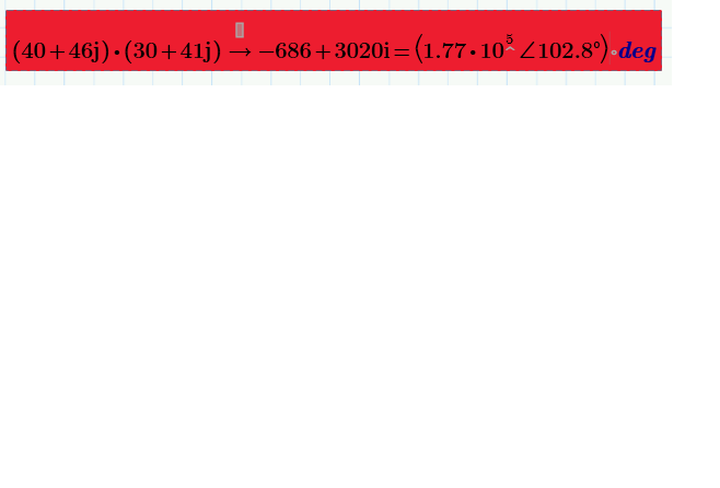

Hi
Why do i get a different answer.

Aaron Garson wrote:
Hi
Sorry, you have used dig twice
