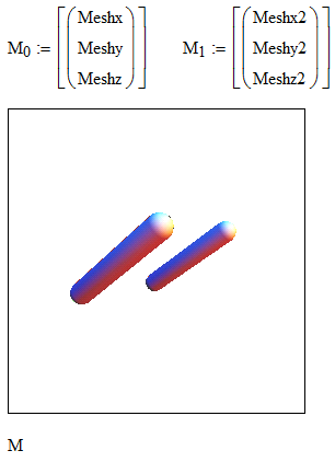

The QuickSheets have very little about the Matrix input format. For example I only learned recently that you can do something like:
This is the kind of format information I want about 3D plots. And neither Help or QuickSheets seem to have anything about it. I want to explore all the available methods to see which is the best for my purposes.
