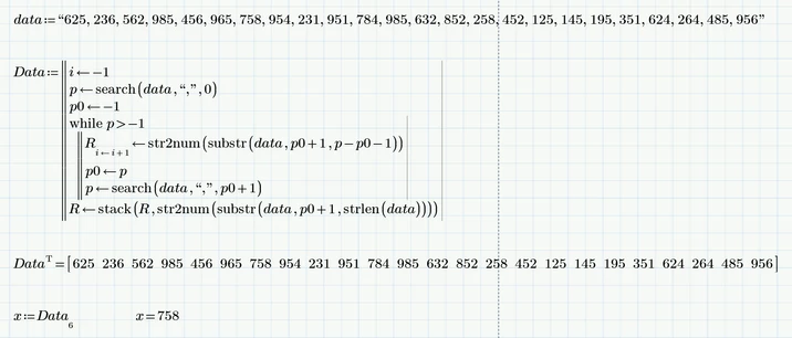

Here is a stupid and dull way to handle the data as its provided in your example sheet:
1) Double click the region with the data
2) Word should open; select the data row and copy it using Ctrl-C
3) Switch back to Prime and type "data:=" (without the quotes) and then press Ctr-V to insert the data. The result should be that you created a string variable containing the data values separated by commas.
4) Now you can write a simple parser to separate the values in the created string, convert them to numbers and store the results in a vector
5) Now you can access individual vector values using the normal ways to deal with vectors.
But I am pretty sure that there will be much better ways to go once you reveal what format the actual data is provided in.
Prime 6 worksheet attached

Copy-paste the text into Excel. If it all ends up on one cell, use "Text to Columns" in the Sort & Filter pane of the Data tab, choosing comma as your delimiter. You'll have to copy the row and paste it transposed into column A to get it into the format you want. Save it as a .CSV
Use READEXCEL to upload the data into your mathcad sheet, or use an Excel component. (Your choice, based on what you're most comfortable with). Once you have an array loaded up with your excel data, you can play with it in MathCAD however you wish.
Does this help?
