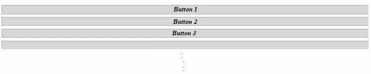

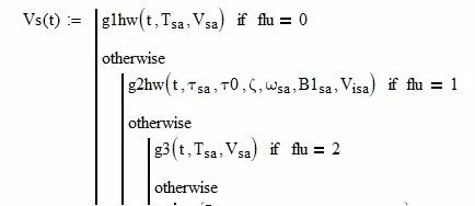

In the main file, add all the references. Then for each fluid you can use a radio button (or button). All the radio buttons will be associated with the same integer variable, for example "flu", so that when you choose a radio button (see example image ), flu will take an integer value and automatically provide the values or other of the chosen fluid.
Buttons as keys:
to the button 1 is associated flu=0, and so on.
where the functions g1, g2, g3, ... are defined in a reference file.
The variables and constants defined in the references cannot be redefined elsewhere otherwise there is a risk of a crash and the loss of the file.
