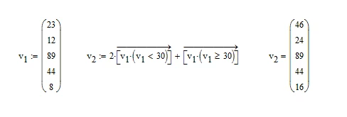

June 28, 2018
As follows:
Alan

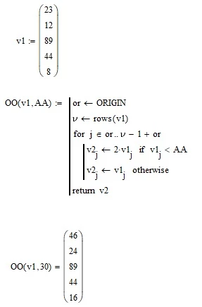

June 28, 2018
es kann auch klassisch gemacht werden ....

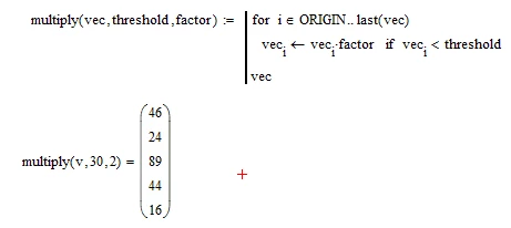

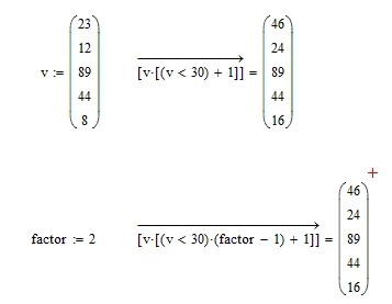

June 28, 2018
OK, so here's a third variant
and here a further "classic" one turned into a function
