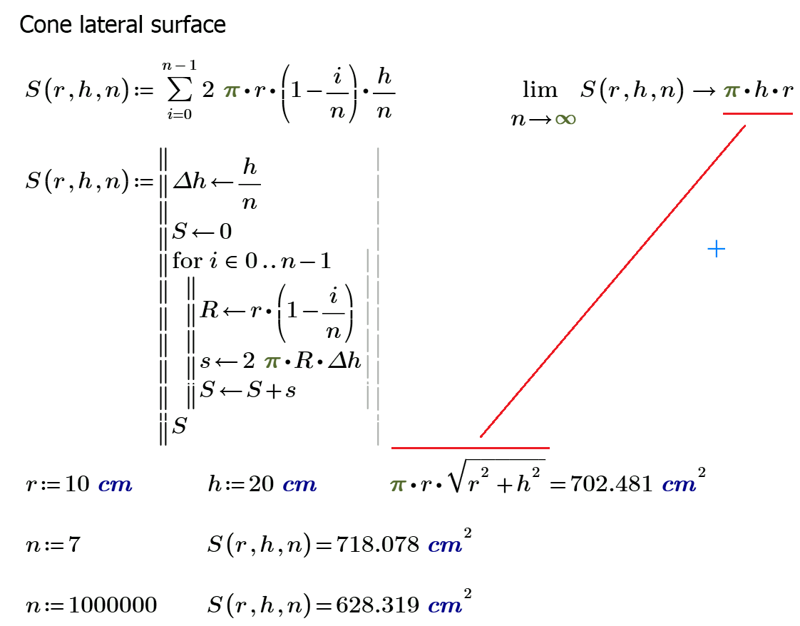

Your expression for S only adds up vertical heights, not slant heights.
Alan
Jan 15, 2015 11:43 AM UTC
Shouldn't that be equivalent, when going to the limit ?
Back to something more academic, to me, it is like the trapezoidal rule VS forward or backwards rectangle method: when going to the limit, shouldn't you end up with the same result ?
Damn, university was such a long time ago ...
23-Emerald I
Jan 15, 2015 5:21 PM UTC
you have to add in the slant!
