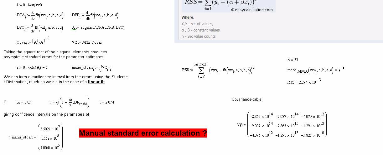

Hi friends,
I really can not find the error, why the manual calculation of the std errors of the parameters are completely wrong compared with confidence function.
Can anyone help, please?
Walter

No!! I can not find the error in my sheet. Please help.
Here confidence.
June 3, 2016
Your Covar matrix is wrong. The elements on the diagonals are variances. Since the variance is the square of the standard deviation it should never be negative.
