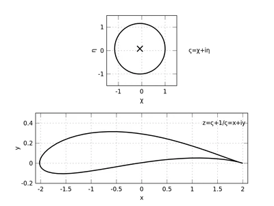

I would like to implement a MATHCAD PRIME worksheet to map a solution on a circle to another domain. This technique is well known as conformal transformation. However, I tried to solve it numerically without success. I use this to predict the potential flow pressures around a body in 2D. Does anyone knows if this problem has already beel solved and indicating in which thread? I tried with the search function on the website, but no results. Thanks in advance for the support.

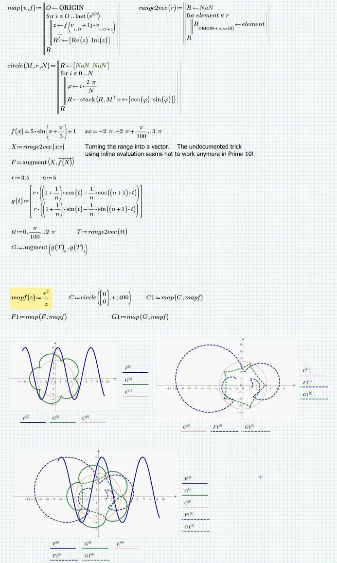

Which kind of conformal map function do you have in mind? f(z):=1/z or inversion (f(z)=1/conjugate z).
Here is a quick hack. The mapping is done point by point, not analytically.
You may chose your own mapping function.
Hope it helps.
Prime10 file attached

Thanks for the mapping solution. Unfortunately the domain I need to map into a unit circle is not described with a function, but by points. I am talking about a wing section.
I think that if I provide a vector of value your algorithm should work. Am I correct in my understanding?
