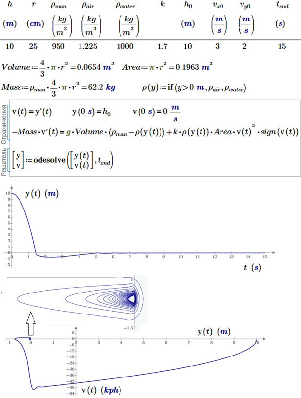

Now we can use units in the Odesolve function of Mathcad Prime!
Why do You not use units.
See one example (a diver)
