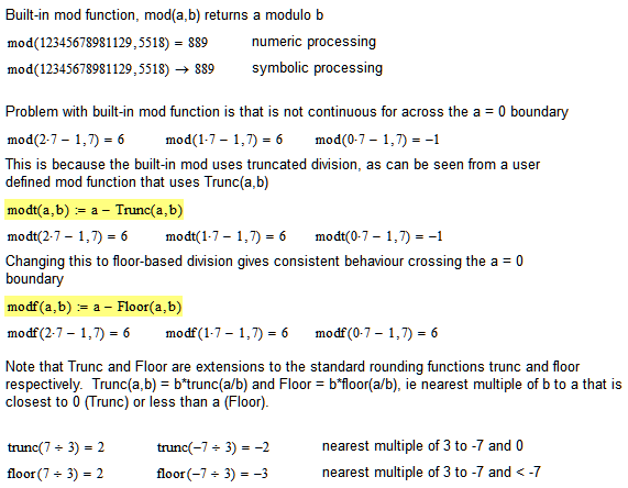

October 11, 2015
Look up the "floor" function.
October 11, 2015
Or the "mod" function.

October 11, 2015
And here endeth the beginners lesson in Mathcad
Interesting observation about the built-in mod function though
