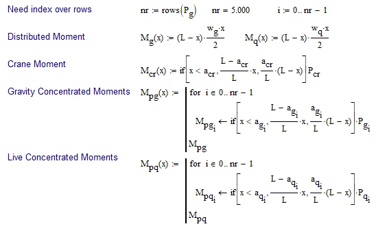

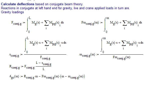

I am currently writing a Mathcad Prime 5.0 design sheet for a symmetrical three span beam.  I have calculated the moments and shear along the beam and have also determined the cracked section properties.  I am interested in how to include the conjugate beam method to calculate the deflection at 10th points along the beam.  Has anyone written a sheet that includes the conjugate beam method as I have stated that I can use as a go-by?
July 24, 2019
Deflections of a single simply supported span by conjugate beam.
Cheers
Terry
July 24, 2019
The equations of moment with respect to x distance from left hand side are:
You need to include two more for the end moments -M.lhs and -m.rhs

July 24, 2019
Thanks, Terry.  I'll take a look at it and see if I can make it work for my 3 span reinforced concrete beam.
I'm also using Mathcad Prime 5.0 so there will be some programming modifications.
