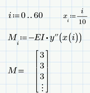

Constant multiplied with the curvature y"
Please see attached file. How can i get a constant value for (EI) to be multiplied by the results of the curvature y"(x)?

 But then your range variable "x" must consist of integers only.
Which makes your approach VERY limited, especially given that an additional constraint is that the range variable must start with ORIGIN as the first value!
Also it seems that @SFares  wanted to define a function, not just a vector of values.
For more flexibility you could use something like
but again M is not a function but just a vector of values.
You may also note that it was necessary to use the (IMHO silly and wrong) alternate way of accessing vector elements by using the vector as if it would be a function, x(i) instead of x[i.
If we use the correct vector index here, Prime throws an error which seems to be related to the bug I mentioned in my previous reply.

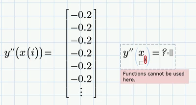

Or compare this
Sure a bug.

Ranges should only be used in three cases:
1) To index the elements of a matrix or vector
2) To define the abscissa values for a plot
3) To create a for-loop in a program
You defined x as being a range but used it for other purposes.
You should define x as being a vector rather than a range!
While playing with your sheet I found what i consider to be a bug in Prime. A derivative using the prime operator throws an error when used vectorized -> Bug in Prime with vectorization and prime operator..
See attached P11 file for further informations
Or compare this
Sure a bug.
